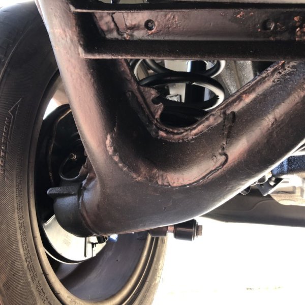

I think I’m just about a big enough idiot to try and save it. Lee can hopefully get it roadworthy and I can tackle the suspension when time and money allow.
There’s nothing in that list that isn’t fixable with a bit of patience.
Those arms, I’d want to know exactly how bad they are before splashing out on new. Batter them back with a flap disc, or steel brush in a grinder. BMW arms are 2.35mm thick minimum, so likely formed from 3mm steel. They’re wax filled, so they rust from the outside, they can look really, really bad, but still be useable. Quite easy to reinforce, or reinforce further than standard.
I got a pair of 2.8 arms cheap that were described as probably scrap, I’ve welded quite a few suspension arms over the years, both Z arms were a simple, though time consuming, fix. My time is my own, so I don’t care.
Grind them clean, go over with a small ballpein hammer, find out if there are any ‘soft’ areas. You can also heat it with a blow lamp, OUTSIDE, in case it goes Woomf, any porous areas will ‘sweat’ from the wax inside. If the damage isn’t significant, cut out and replace the soft area(s). Reinforce to death. Sorted.

That’s a real nice job. Wish we had someone who would do that for us.
