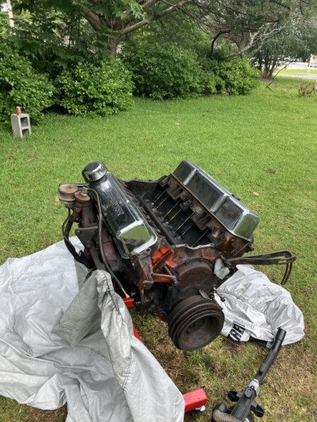

The engine and trans combo specifically being a bone stock Gen1 350 SBC and a TH400, out of a running driving car, needed some general TLC and cleanup with the only "issue" being an oil leak from the valve covers that being said i had the intention to do a complete refresh of the engine regardless
I started by separating the engine and trans and mounting it on the stand

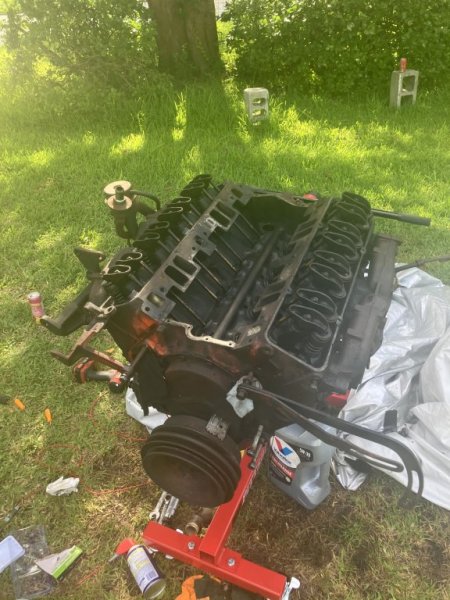

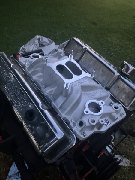

I started by removing the intake manifold to get an opportunity to clean the block, replace the intake manifold gasket and replace with a new Edelbrock performer manifold (regardless on opinions of better or worse intake and carb brands or setups the most important part to me is its what every local parts store has in stock
Absolute ton of carbon build up but after a bit of careful cleaning vacuuming etc. managed to get it sorted (unfortunately don't have an after photo)

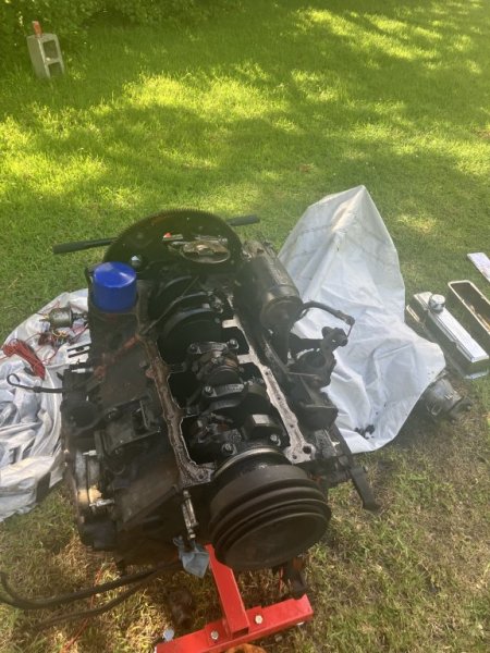

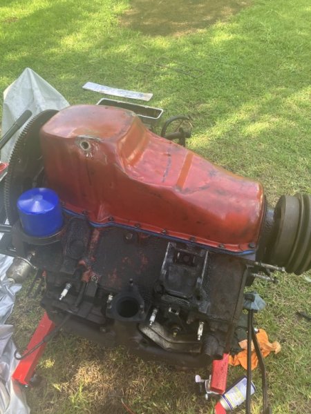

proceeded to remove the oil pan in order to replace the oil pump as well as the oil pan gasket

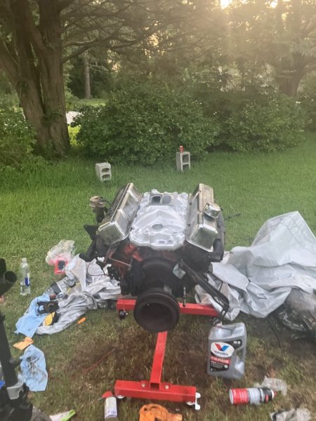

went ahead and reattached the new intake manifold as well as the valve covers with new gaskets and some sealer on the edges of the manifold

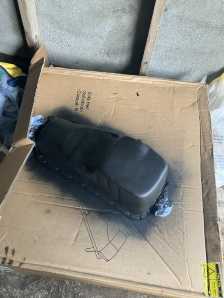

quick respray of the oil pan and reinstall on the block with high temp satin engine enamel and reinstalled with a new gasket
skipped a few steps in the photos but used some brushes, and wire wheels with engine degreaser to clean up the block and used satin engine enamel for a solid respray

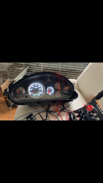

throughout the week i started adapting the wiring to the stock interior of the car, i cut apart the center console leaving room for the radio and cut the back of the stock gauge cluster, fabricated a small metal plate to hold the gauges for the swap, painted it and adhered it to the setup leaving a semi stock look, keep in mind the upper switch panel was what was already wired to the engine on the stand, (please note there are some variations in later photos since then)

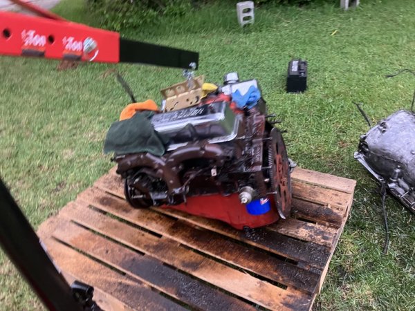

I started by attaching the shifter linkage, and cable from my B&M Cable shifter to the th400, immediately after we took the engine off of its stand and muscled the transmission onto the engine preparing it for install
we proceeded to get it raised with the trans pointing in towards the tunnel and pushed the car into position
we lowered the engine and trans and pushed the car forward and repeated until it was in the car around where we wanted
