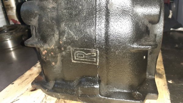

Hello to all,
I have to refurbish the differential of my 1996 BMW Z3 1.9.
I have never put my hand to this differential and at first sight I find it different from the standard LSD ones where on the cabinet there is the letter "S" while in that of the Z3 there is the letter "R" someone knows what the letter "r"?

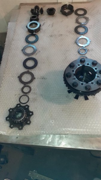

To understand more, I opened it and found a strange situation.
It is a clutch disc differential only that unlike other differentials inside I did not find the preload discs but only 4 clutch discs coupled to the 4 dog's ear discs.
I have a feeling that the owner before me has somehow "tampered with" by replacing the preload discs with 2 other clutch discs to have a greater locking but these are just my hypotheses and I ask you if you have ever experienced this type of differential.
I am attaching a photo of the components of the differential lock arranged in a disassembly sequence and if anyone notices any additional or missing components, I thank them infinitely for the help.
thank you all
